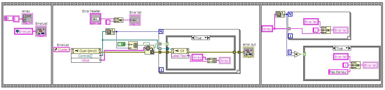

In my application I was using in my subVI a cluster of booleans for the different types of errors I could have.
It wasn't really convenient to manage all these clusters so I decided to create a global one.
Now the problem is that I'm not able anymore to extract the labels and values of this cluster. Before I was passing as a reference theses values but I think there is no way to create a reference directly from my global variable (cluster).
So as you can see in this printscreen I created a new array indicator in my VI. But if I am adding a new boolean value in my global cluster I need to create again the cluster and it is not really convenient.
The goal is to list the errors in a string only if the value is true.
I don't know if I am clear, if not I can explain more.

I tried this way :
But as you can see when I wire the "Clust (strict)" to my reference (which is the control in my global variable), I don't know why but I could have access to this class...I did something wrong ?
Because the reference is for sure the cluster.
Oh my god, I think I would give up to find an automatic way, I can still delete and create again my control each time I do a modification to my global...Because I already lost so much time.
It just sound weird for me to have so much difficulty with LV just to extract the names and values of my booleans in my global variable

Hi remvu,
have you tried to insert a "to more specific class" before the ctl-property node?
As you still want to know the names of the booleans you should really give a shot at typedefinitions...
