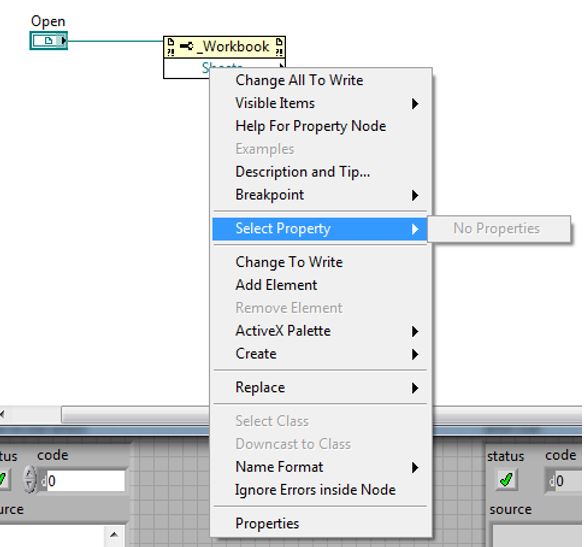

    I'm having trouble finding the correct object to manipulate Excel sheets in LabVIEW.  I've created VI's that will find data in Excel sheets and then export it but now I need to go the other way and import data into Excel.  One of the things I need to do is run a macro in the Excel workbook to format all of the graphs but I can't figure out how to get the correct "Property Node (ActiveX)" block in my VI.
I know my starting point is the (1) "_Workbook" VBProject block but I don't know how to get it.  When try to select the correct property I get no options (2).  I tried changing the reference but I can't find the Excel ActiveX Class Library in the list.  Does anyone have information on how I can go about accessing the needed properties in the Excel ActiveX Library?

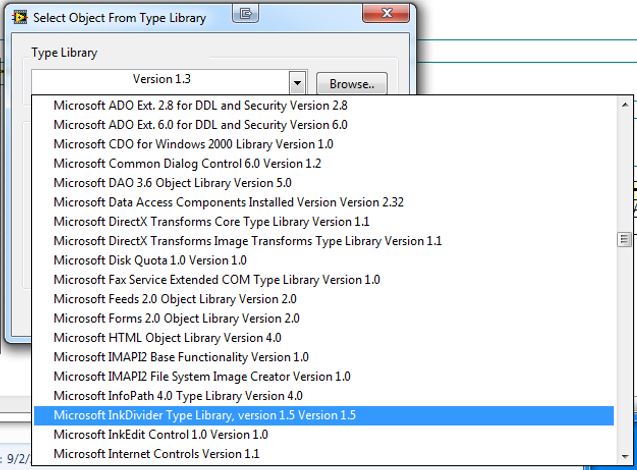

Just click the drop down menu and select the Microsoft Excel object library, which gives you access to Excel using ActiveX.

P@Anand,
   I didn't have the Excel Object Library listed under the drop-down.  Upon browsing I was looking for an Excel OBJ or DLL file which would import it in but it doesn't exist and you actually have to select the EXCEL.exe file to get access to the Object Library.
