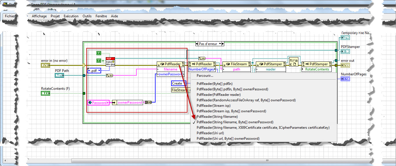

Hello JM,
I have modify the palette like this
But in the end the pdf lose permissions.
There is an change in an another Vi ?
I don't have the version 2.0.
Where is it ?
Thanks for your help

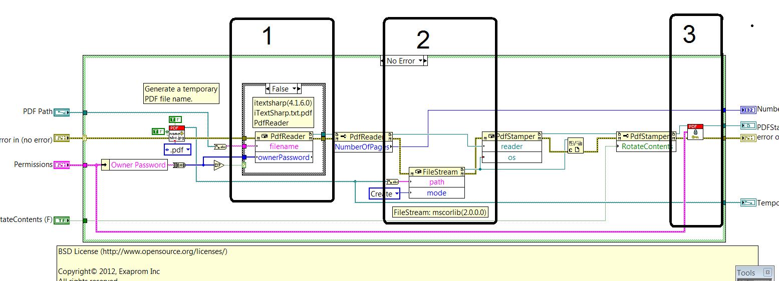

1) We open the previous PDF file with the password and permissions (you have already done that).
2) We create a PDF File with a temporary name.
3)  We set the permissions for this file.
Message 15 of 17
(1,832 Views)
Accepted by Jacouille
Many thanks for your help
It's exactly what i ma looking for
