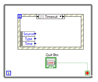

I'm trying to understand the nuances behind Event Structures.  I have a very simple VI which just has a "Quit" button.  It works great - when the Quit button is pressed, the VI stops:
If I add an Event Structure without adding any events, the Quit button no longer works correctly:
There is no timeout event and no other events to handle, so why would the presence of the Event Structure interfere with the Quit button?
Then, if I add a timeout then the Quit button works fine again:
What in the world is going on here?  I do know that adding an event handler for the Quit button fixes the problem, but I'm more interested in understanding better what's happening behind the scenes.
That's not correct. There IS a timeout event as evidenced by "Timeout" at the top of the structure. By not wiring it you have left it (the timer) at the default value, which is -1 (no timeout). That means it will wait for an event to fire forever, which never happens since the only event it's listening to is the timeout event that never occurs.
You can't delete that event case until you create another one because an event structure with no event cases doesn't really make any sense. (No cases = just delete the structure!) Though I should add that you should only create a structure with no timeout if you know what you are doing and are certain an event will eventually happen. If you are in a situation where you might want the loop to terminate without an event firing then you should wire a value to the timeout so it will eventually stop waiting for an event.

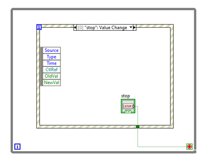

For the simplest possible event based architecture, move the button inside the event structure, then right click on the event title and select "Edit Events Handled by This Case...", and change the event being handled to the Value Change event on your button.
e.g.:

Just reread your last statement where you say you already know you can add this handler... What's happening behind the scenes is that the Event Structure is basically a function that waits for an event to fire, then executes whatever is inside of the case for that event. You would see the same behavior with "Dequeue Element" or "Wait on Notifier" if you don't wire the timeout. Your button hasn't stopped working without the timeout event, but the while loop will not exit (or move to the next iteration) until all of the code inside of it is finished executing. Without a timeout value, the event structure (or any of those other "wait for something" type functions) will never complete its execution.
The loop cannot go to the next iteration until everything in it has completed. If no event fires, the loop can never go to the next iteration.
Everything that does not depend on other things will execute in parallel.
When the VI starts, the button value gets read immediately (still false). When you press the button now, the new value (TRUE) would get read at the next iteration, but it cannot go to the next iteration because the event structure has not finished.
You need to fully understand the magic and power of dataflow and thins will be obvious. 😄
