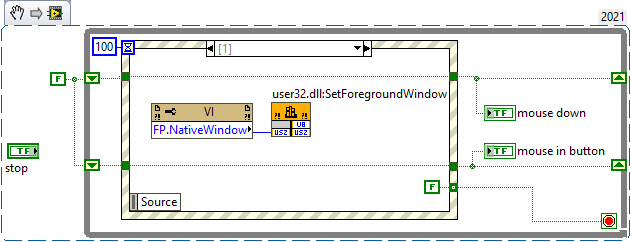

Hello, I am wondering if there is an easy way make the user events more consistent when the front panel of a VI is not the active window (in Windows). I notice that when a front panel is running but not the active widow I still get button animations and mouse enter and exist events but I don't get button press or mouse down events unless I first click on the window to make it active. I would really like to get the button press and mouse down events even if the window is inactive. If that is not possible, I would like to disable the animations if the window is inactive. I have provided a VI that demonstrates this behavior.

I think this works
I don't know why the Event Structure is blank, should be Pane:MouseEnter
Snippets do not maintain static links (UI events, locals, static refs, linked properties, linked methods) to front panel elements that cannot be included in the snippet itself, such as panes and splitters.
