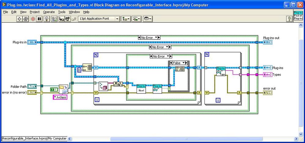

@Mark_Yedinak wrote:
@Ben wrote:
if you are attempting to develop a Factory Pattern then all you need is a case structure that has each of the children in each case. No input wire required aside from the enum selector.
Ben
In OOP a parent method should never have any knowledge of its children or descendants. It really breaks the whole concept of OOP. The factory pattern is a helper function which would know of the parent (or base class) and instantiate a specific instance of a child class based on some input or parameter. This should not be part of the base class since it violates the rules of OOP. A more flexible way of doing this is to use plugins so that the helper function does not need to be modified when new children class are added. It would load them from disk dynamically.
The case structure works fine if you will never, or very rarely adding children classes. If you foresee the need to add more children in the future you should really consider using a plugin architecture.

This is an image from my gallery going back to about LV 8.2 where I did what I think you are describing.
Giving credit where it is due... I believe I learned that it was either Tomi Maila or Ton Plomp that taught me that.
Spoiler
Regarding the missing error cluster wire between loops. I did tht myself and nobody had to teach me how to do that. Smiley Sad
Ben
