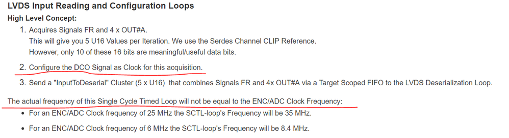

400Mhz is the frequency of ADCs bit clock. I want this clock as the source clock of acquisiton SCTL. Now I know that is not right. I shouldn't use DCO directly.
I refer to this example to design: https://forums.ni.com/t5/Example-Program-Drafts/Communicating-with-an-ADC-via-an-NI-6587-FlexRIO-Ada...
It was said in the example that the frequency for this SCTL should be a clock deried from DCO.
The FPGA hardware in the example is NI 6587, which has a STROBE port for incoming DCO. But my hardware is sbRIO 9651, and the DCO is connected with DIO_63 of sbRIO 9651. I tried to use one MMCM in CLIP Generator for DCO, but there is a LOC error:
ERROR: [DRC UCIO-1] Unconstrained Logical Port: 2 out of 184 logical ports have no user assigned specific location constraint (LOC)....Problem ports: aDio[63], and aDio_n[63].
How can I use a slower clock derived from DCO for SCTL?

This example is really intersting. It use a  programmable oscillator to specify the onboard clock which is divided by 5 inside the CLIP.
As far as I know there is no such a component for the SOM.
I didn't realized but if you want to import an external clock, the direction I'm seeing on your first post is not correct, for importing a clock you need to choose "From CLIP" option
I've also observed in the CLIP Generator that the DIO_63 is single-region clock capable. Have you just tried DIO_62 as a simple test, I'm not familiar with this error, but it worth to test it because in case of doubts, it is advised to use a mult-clock capable.

Thanks for your reply. The problem was solved. I should set DIO_63 as lvds_25. Because the external clock port is lvds_25. I also seleted 'supports derived clocks' and a divided clock from external clock(100Mhz) for SCTL worked fine.
