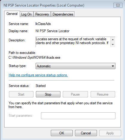

rolfk,
this is looking close to solving my puzzle.
On problematic machines, NI Service Locator is not running.
This is what I have on a machine with the problem:
I am not sure what "PSP" means, but it is not nisvcloc.exe.
http://localhost:3580/dumpinfo? returns error page on RTE-only machine.
On "good" machines I see NI Service Locator in the list of services.

I solved the problem by deleting and remaking NI Service Locator.
The steps to do this (from here https://knowledge.ni.com/KnowledgeArticleDetails?id=kA00Z000000P6fLSAS&l=en-US😞
  1. Open cmd.exe and run the command: sc delete nisvcloc
  2. Restart the computer
  3. Open cmd.exe and run the command: sc create NiSvcLoc binPath= "C:\Program Files (x86)\National Instruments\Shared\niSvcLoc\nisvcloc.exe -s" start= auto DisplayName= "NI Service Locator"
  4. Restart the computer or manually start NI Service Locator.
My main problem was that NI Service Locator was not in the list of available services, therefore I did not know that it has problem starting. After remaking, it appears in the list and can be started.
Thanks everyone and, especially, rolfk for pointing out to Service Locator.
