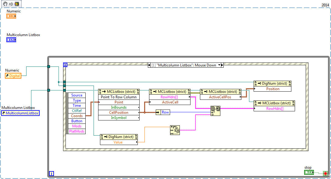

Edit rownames in multicolumn listbox at runtime using keyboard

Here you need to follow some order
Get the cell position from Point to row column and then provide thsi cell position to MCL Property node as Active cell the use another property node to get active cell position
Maintain the same execution flow you will get the active cell position
Message 12 of 23
(2,409 Views)
Find the attached image for your Reference

Ah fine.
Still the indicator is not in the right position:snip.png

you want to place the numeric indicator in the MCL in the specific cell which you click right?
long before the expereinced the same and it worked for me.
Even you can use visible peoperty to make the numeric indicator only visible after clicking the cell

Have you  tried my snip? I can't get it working
Attach  VI...

After setting the position of the Numeric control, try to use the property "Key focus" of numeric control. So that when user types in the keyboard, it will update the value of Numeric control.
Then try to set the value of the particular cell in list box, using "Numeric ctrl" Value change event case.
Your Control hides behind your MCL, so select the Numeric control and use brint to front (ctrl+Shift+K)

Thank you for your advices 🙂
Nearly there now. Only the position of the numeric is not perfect.
