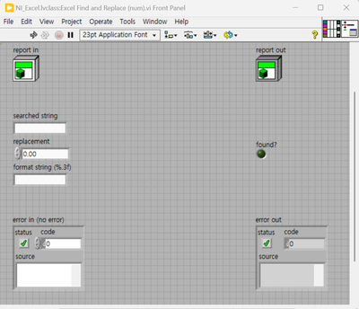

Hello! I need to build an exe file using Labview 2022. The problem is that build fails with error 1502 which occurred at AB_Source_VI.lvclass:Close_Reference.vi -> AB_Build.lvclass:Save.vi. The error message gave me the possible reason, so I opened the vi of the following directory.
C:\Program Files\National Instruments\LabVIEW 2022\vi.lib\addons\_office\excel.llb\Excel Find and Replace (num)
It turns out the vi is broken (like the picture below).
The program I made should open the Excel template and save some numbers with a new file.
I hope I can get any clues or solutions to solve it.

That has happened to me a couple of times. The Report generation toolkit is based on an older Excel and sometimes calls are changed. Open the VI and fix the call.

Agree. But beware that if the target computer contains an older Excel version than the development computer, the fixed vi may not work there.

I have the same problem. I cannot build my exe due to this broken VI in the Excel report generation toolkit.
I know how to fix the broken VI, but it's not allowing me to save it.
Please advise.

When you get this error message:
It means one of two things.
First, it could just be that the file is set to read-only.  Find the current file in explorer, right-click it, select Properties, then uncheck Read-Only.
If that's not it, then you legitimately might not have permissions to modify files in "Program Files" with your login.  You might need to speak to your organization's IT department to get permissions to those directories, or you might need to run LabVIEW with admin rights (log in as admin and/or start LabVIEW with the "right-click -> run as administrator" option).
