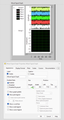

Does anyone know how to stack plots by group? I'm struggling. Read below to better understand what I mean (VI attached)
I know how to stack plots individually as shown below.
This below is what I would like to achieve but I just don't know how to go about achieving it. I want to group voltages in one chart and all the pressures on another chart. Both charts will be sharing the same x-axis (time).

it is definetly easier to use two charts as Gerd suggested.
but, you may consider a mixed signals graph using two groups.
note, this is a graph not a chart, so you need to built a buffer inside the loop for each plot to mimic a chart.
furthermore, you have to manually drag and drop plots from one group to another.
also, scaling a mixed signal graph is tricky compared to the usual graph and charts
1# set-up your .vi like this
Spoiler
2# spawn a fresh mixed signal graph and connect it to the last bundle array node
Spoiler
3# run the .vi once
Spoiler
4# spawn group 1 by rightclick> add plot area
Spoiler
5# resize the mixed graph area height  via Properties>Apperance from 219 (default) to 482
Spoiler
6# drag and drop plot 0, 1 , 2 into group 1
Spoiler
