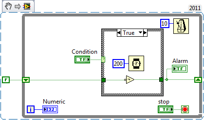

I do not really know what you tried to achieve in the last version. I didn't suggest you to replace "Tick Count" block, but the "Wait" function inside the for loops that are used for controlling LEDs.
I will not give you a ready solution, but I can give you a hint. Consider the diagrams (they are VI Snippets) below:
We have a boolean control "Condition" and a boolean indicator called "Alarm". Whenever "Condition" is true, we will start blinking the "Alarm" every 200ms. What would happen in this implementation? The same as happened to you before - setting the condition to "1" would not only start blinking the LED, but it would also delay the execution of the WHOLE program by 200ms (when you run the code, please notice that when you change the value of "Condition", the "Numeric" indicator also starts to increase slower).
How to do it correctly?
Have a look below:
This time, when the "Condition" is a true value, we do not delay the execution, but we start the timer and in each subsequent iteration we check whether set time (200ms = 0,2s) has passed. If it has, the signal changes it's value, hence the diode blinks.

I understood the difference between the two snippets and the way to avoid slowing the code, but the concept behind each is different.Smiley Sad
  • The first one indeed slows the code when it is true but the LED is on(continously for 200ms)
  • The second one has an LED that turns on and off hundred time a second without being on for 200ms.
In my previous vi, the LED turnd on for 300ms and turn off directly; now I have changed the code I believe that it is IMPOSSIBLE to keep the LED as in the previous vi on for 300ms and then off.
  1. If there is no solution for such a problem, I'd rather stick to my old vi.
  2. How come the graphs are different in the begining of the running of the code?
Thank you
