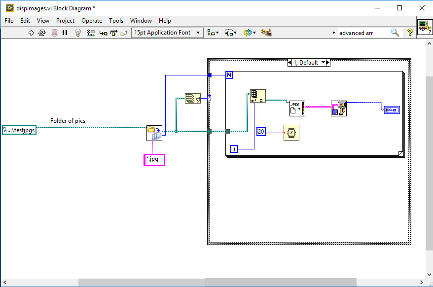

Hi all,
I am trying to display a series of 100 images as a slideshow with a constant delay between each picture. I am trying to get the framerate of the slide show to be about 60Hz (or as fast as Labview can do). I'm not too sure how fast the fps of my slideshow is right now, but it does not look to be 60Hz (it looks much slower).
I have looked up some possible solutions to what I assume a bottleneck in opening and drawing a jpg image. One solution I read was an image buffer. I'm not too sure how to implement this. I am new to Labview, so any help in finding an elegant solution would be appreciated. Thank you!
(1): Pseudo code of what I am trying to do
for(i=0; i<Num_pictures; i++){
 display(array_of_pictures[i]);
 wait(20ms); //this would give me a fps of 50. If I could achieve this, it would be great.
(2) My block diagram
(3): For your reference, this is the first picture I display. I am trying to display 100 images. The white block is 10x10, and moves across the black screen (100x100) left to right until it ends up at the bottom right corner.

Hi agin,
why don't you follow your own pseudocode?
To improve execution speed you should load all images into memory first - before showing them in the loop!
And please use the autoindexing behaviour of loops

Hi agin,
how to load all images into memory first?
Well, use an additional loop to load all images.
Then start the current loop iterating over all images…
Message 4 of 18
(4,965 Views)
Now you're trying to read 50 jpeg files/second from disc, which'll be hard.
Just do your first loop without wait and gather up the Image refs (index output, which should be the default output of a for loop), and you'll have your picture array. Then loop through those at 20ms and see how it turns out.
/Y
