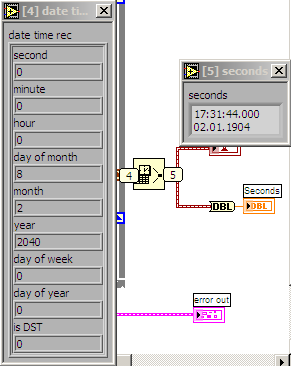

Thank you for thr warning.
After looking at the code I tried a "monkey test" putting silly dates.
For some reason the "date/time to seconds" :
 - works fine until 19/01/2038...
 - from 20/01/2038 to 06/02/2040 gives this :00:00:00.000 DD.MM.YYYY
 - after 07/02/2040 seems to start back from : 17:31:44.000 01.01.1904
I think the "seconds" can lead to an explanation...

That is just the limit of the LV timestamp. I forgot it ends at 2038. The 8 representation now allows having dates from 1600 to 3000.

The internal limit of the LV timestamp is actually around 58 billion years from its epoch, midnight, January 1, 1904 GMT.  It is the number of seconds since (or before) the epoch expressed as a 128 bit fixed point number with 64 bits as the integer and 64 bits as the fraction (thus the ~58 billion years).  The limitation is in the format routine only, and only exists because the previous timestamp format (a simple double) could not go past 2038.  It has not been fixed because it is an uncommon problem (which will become more common as time goes by - it will get fixed).  You can directly manipulate the timestamp yourself by typecasting it into a cluster of two 64bit integers or four 32 bit integers (depending on your LabVIEW version).  Remember that it is a signed number.  You can find examples of this buried in vi.lib at <LabVIEW>\vi.lib\waveform\TSOps.llb.
