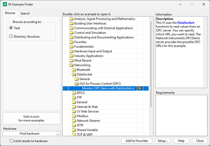

What part of this process are you stuck on right now? To start out there is an example (Help > Find Examples) that shows how to read OPC DA tags using datasockets.

Wow I had no clue that was there. I believe there are around 10-20 tags the program will be reading from the plc. I've honestly haven't got much done. I've been trying to figure this out from scraps I find on the forums and have been kinda going in circles.
