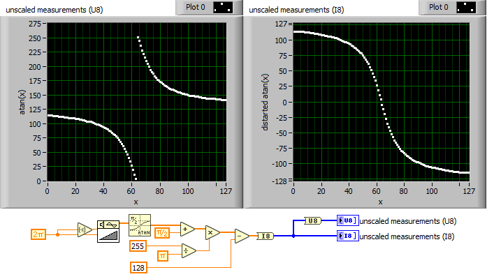

Hi, i`ve got a problem with function on wavegraph (atan). Is there any way to get rid of this middle line in between of the waveform? Or is it a problem with used data from accelerometer

While this will cosmetically solve the display problem, you mention Levenberg-Marquardt in the subject, so I assume that you maybe want to apply a non-linear fit to it. For that you need to eliminate these points and maybe even tweak the model.
Your data looks does not look like an atan function at all. What is the actual model you are trying to fit? What does the data represent? What parameters are you trying to get out of this? To me it almost looks like the raw data (before scaling) are signed integers and you interpret them as unsigned, causing wrapping. You need to fits that! Once you do, it will look like part of an atan function!

As I said, your problem is with incorrect interpretation of the measurement data.
Study this! You want the interpretation on the right! (This demo assumes 8 bit data, but can be adapted for any other number of bits)

LabVIEW ( not base development system ) includes the VI :
Unwrap Phase VI
It does the same as Altenbachs solution, eliminating the phase jump.

Agreed, but that is correcting for an earlier mistake. It is significantly better to solve it upstream.
