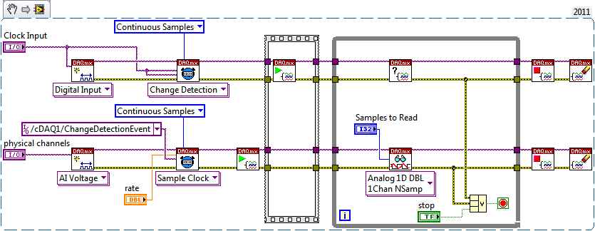

Hi there,
thank you for your answer, Brad!
Change Detection isn't possible in this case, because this operation is only executable in digital operations (I believe it is, because I tried, but maybe someone has an idea). But I have to trigger an analogue measuring which is triggered by, and this is the crunchpoint, two digital tracks of an incremental encoder. Furthermore at rising and falling edge because of sufficient accuracy.
I have a cDAQ-9174 chassis, 2 9215 and 1 9401 module. I have a traversing unit, the position of the x axis is measured by an incremental encoder type "SICK DGS60" with 10000 lines. The spindle has a slope of 5mm/round. So I have to measure a voltage each line of the two tracks to get enough accuracy. With one track (to trigger only by one track is so simply done) I have an accuracy of 0,005mm. But this isn't enough.
I also tried to start the measuring by triggering and then measure with a sufficient rate. But then I have to do that in a while loop to register further edges. Then I have to put the complete task in a while loop, because the task has to be closed each iteration. But then the measuring isn't progressive because of initializing the task.
I have the fear this doesn't work with my hardware. Does somebody have an idea?
Thanks for your help, everybody.
Jan
Message 7 of 9
(5,794 Views)
Hi Jan,
I believe Brad was describing something like this:
You should be able to configure a DI task using change detection timing, which will generate a clock (called "/<chassis_name>/ChangeDetectionEvent") on every rising and/or falling edge of whichever lines you want to use.  You can then use this clock to sample your analog input.
If you're using the 9401 and you have another task running on the module (e.g. an encoder task) you'll want to make sure to reserve both tasks running on the 9401 before starting.

Hi John,
thank you very much for your idea. I tested it and, as far as I can see, it works. Now I'll see if the aquition rate is sufficient.
Jan
