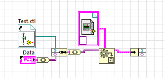

I'm not sure if you mean like this:
Here the value I'm putting into the top of the VtD node knows about the data type it contains, so the To Variant node is unnecessary (as shown in 4->3 case, sorry for inverted order of numbering...)
If you don't have this information (because you need a variant, it might be a different datatype etc) then you could perhaps give the qualified name of the typedef and use the VI Server to open a reference by name?

None of the methods you proposed could work.
In my case, the method to convert the variant to data shall use the reference to the typedef. So, is there a way to get from a typedef control reference the data type (or the value)?
In the picture, what I try to realize

Ah. Yes. Use the Property Node and Value property.
1) Get the value from the generic control reference. That will be a variant. Use To G Data to convert it to the type def of the control.
2) Use "To More Specific" on a class reference created from the type def control. Get the value from it, and it will be the specific value.
Perhaps you should explain a bit about why you want this and how you're using it?
