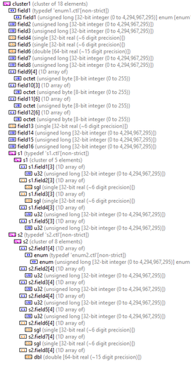

I've seen this asked in the past. Looking to see if any updates have been made or if it warrants a feature request post because this is an issue our team is struggling with. We need to convert complex clusters to byte arrays, without anything extra in them. By complex cluster, I'm referring to the pink-colored ones. These are clusters that contain data more complex than simple scalars, such as an array or subcluster. There are currently two functions that I'm aware of for converting a cluster to byte array:
Typecast - This only works with simple clusters (orange/brown).
Flatten to string (and then convert String to U8 array). - This prepends the size of arrays inside the cluster into the byte array, even with the Prepend Array or String Size set to False, since this selector applies only to the cluster as a whole.
I've seen this topic addressed in the past, with some of the replies including the following:
"Why is it a problem that it's prepending the string/array size?"
"But is that really an issue? How else are you going to be able to tell how many elements are in your array or bytes in your string?"
This is absolutely an issue for us because those byte arrays are being sent to external dlls and/or sent as UDP packets, and being parsed by a 3rd party application that requires the data to be in a specific format. The length of the arrays is already captured inside one of the fields in the cluster itself.
We can manually break apart the clusters and manually build up the byte arrays, but this is a very tedious process. We have a dozen or two clusters, each of them with multiple subclusters inside of them. Additionally, the original clusters are being auto-generated as type defs using some VI scripting tools. This is because the shape of the clusters occasionally changes during development. When one of those clusters changes, we have to now remember to go into a subVI deep in our application to make sure the conversion for all of those new auto-generated clusters is now correct in this new format. It's not very dynamic and maintainable.

How many different types of such clusters do you need?
Dozens of them. Each one is different. Below is a picture and I've attached a simplified typedef example (LV2020CE) of what one such cluster might look like. Now, consider a dozen or two permutations of that, with datatypes, orders, lengths, and hierarchy changing.
Can't you just create a subVI that does the custom flattening? (unbundle by name, flatten each part, concatenate, etc.)*
*Edit: just noticed that has been suggested in the other thread already.
Just look at the example above and imagine doing that for dozens of those. They are very tedious and error prone. Additionally, 3 months from now a developer might decide to add or edit one of the fields in the middle of the cluster. Now we have to regen the clusters, and then assuming we notice the difference, remember to go into the subVI and make the the changes manually. It's a lot to maintain for a very small part of a large test system, especially for changing datatypes, an evolving project, and various engineers and developers coming online and offline on this project.
(Also be careful with wording, the term complex has a special meaning and I don't think that's what you have here)
If you have a better name for them, let me know and I will edit the post.
Anyway, I spent a few hours tonight developing a VI that will convert a Variant to Byte Array without anything extra in it. This should work on a bunch of different datatypes, including all real numbers, booleans, strings, paths, arrays (that include the aforementioned datatypes), and clusters of all of the above (the VI is recursive to process clusters).
One other thing I forgot to mention, and to explain the methodlogy. This VI is often used on Windows in addition to Linux x64 on RT targets (cRIO and PXI) as part of Veristand deployments. One of the limitations we ran into early on is that property nodes do not work well on RT targets, because the often put out default values since FP objects are not really a thing on RT systems. This could have been due to some sloppy development early on as we were learning to implement these in Veristand Custom Devices, but we just decided to abandon all property nodes to avoid any issues with deployments. Therefore, this entire solution uses Variants and Data Type Parsing functions.
Anyway, enjoy. For those of you who get to try this out, please test and let me know of any bugs. I finished it late at night and several beers deep.
Next up: byte array to cluster (much harder problem that will likely involve vi scripting).
https://github.com/aaronfleishman/VariantToByteArray
