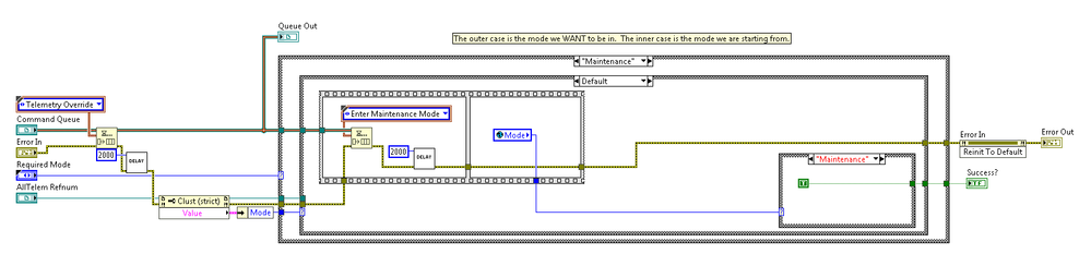

The project I am working on is an automated tester for an external device which we communicate with via serial port.  In our original implementation of the project, all data for the device is stored in a single cluster, which itself is stored as a hidden indicator on the main VI and whose reference is passed around to every single subVI so that the comms subVIs can update the data and everyone else can see the latest data in real time.  I recently discovered global variables and think that they might be a better fit.
My goal is to have each item that is stored for the external device as a separate control in a single global VI.  I am aware that accessing globals copies the data, so I would break the cluster into all of its individual components to make sure everything is as speedy as possible.  Here is my dilemma: because there is one thread working on comms all the time, we have some queues which send commands to the comm, which sends commands to the device, which responds soon afterwards.  At present, I can control when the software looks at the telemetry data by using property nodes for the control reference with the error in coming from the error out of the command node.  I have attached a simple example of a subVI I made to get the device into its Maintenance state; you can see that I pass a command to the command queue, perform a 2-second synchronous delay, and then read the telemetry from the telemetry reference.

Let me take an extra second to comment on the "Delay" block, because it's a perfect example of what I am trying to achieve.  Before, if I wanted to delay for 2 seconds after something occurred, I had to use a sequence structure, like so:

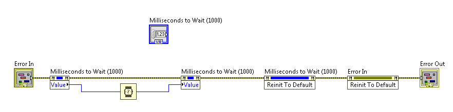

Stuff like this used to be ALL OVER the code base.  I know sequence structures aren't generally best practice, but I wouldn't have needed it if only the Wait (ms) block had the error in/out nodes most other VIs do.  So, I made my own:
Now I can control exactly when in the subdiagram the delay occurs and ensure nothing downstream runs for the amount of time needed.  Best of all, the other threads, such as communication, keep running perfectly in the background during the delay.  So, I am looking for something similar with globals.  For controls/indicators on the current front panel, I can just grab a property node and wire the error in/out lines to control when the read takes place.  Without it, I am looking back at using sequence diagrams:
The only solutions I can think of are less functional than the current model of passing the telemetry reference around.
Hm.
You traded the sequence structure (not the worst option) for FOUR property nodes (terrible option).
If this is subVI, this code enough
I think a good idea would be to skip the pause if there is a mistake.

In terms of time or space of execution for the step, I would agree that the extra property nodes add a lot, and I can also agree that the delay should be skipped if an error occurs.  However, as far as I am aware, the only way to ensure that an unwired terminal is always called with its default value is to reset it to its default value at the end of the subVI's execution.  If there is some other, simpler way, I would love to know about it because I have added those "Reinit to Default" Invoke nodes in a lot of subVIs where I want an unwired to be set to the default.  Like, if I call the same Delay subVI twice in a row, first wiring in "2000" and then wiring in nothing, the control will retain the "2000" from the previous execution and make it run 2 seconds both times instead of 2 seconds the first time and 1 second the second time.
I didn't see that (edit: I tried with "wait.vi" as non-reentrant and preallocated, and didn't see it in either case, just in case you wondered if it was due to reentrancy).
Well, I'm a bit flabbergasted.  I have no idea what I did on the VI that was retaining the previous values, but I just copied what you did to test out my Delay subVI without all of the "Reinit to Default" stuff and it worked.  Good to know I can remove all of that stuff from my other subVIs.  I'll double-check to make sure they're all set to non-reentrant or preallocated as well.  Thank you for alerting me to this.
