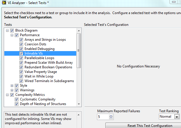

Greg,
while i appreciate your effort, i would expect such features to be part of the VI Analyzer. In fact, inlinability (does this word exist at all?) is already tested with VI Analyzer:
So do you think it will be possible to integrate your effort for the compiler optimization analysis into VI Analyzer for e.g. 2012 SP1?
Norbert

Hi Norbert -
I chatted with Darren about this, and we decided that the tests that already exist in VI Analyzer make more sense, especially the "Complexity Metrics" ones since they call out specific things you can do to simplify your VI.  I will admit I didn't know there was an "Inlinable VIs" test...somehow I missed that.

Greg,
but VI Analyzer does not (at least, i am not aware of it) tell you what compiler optimization level was used for the individual VI. I think this could be valuable information, too. And i understand that your tool does test this 😉
