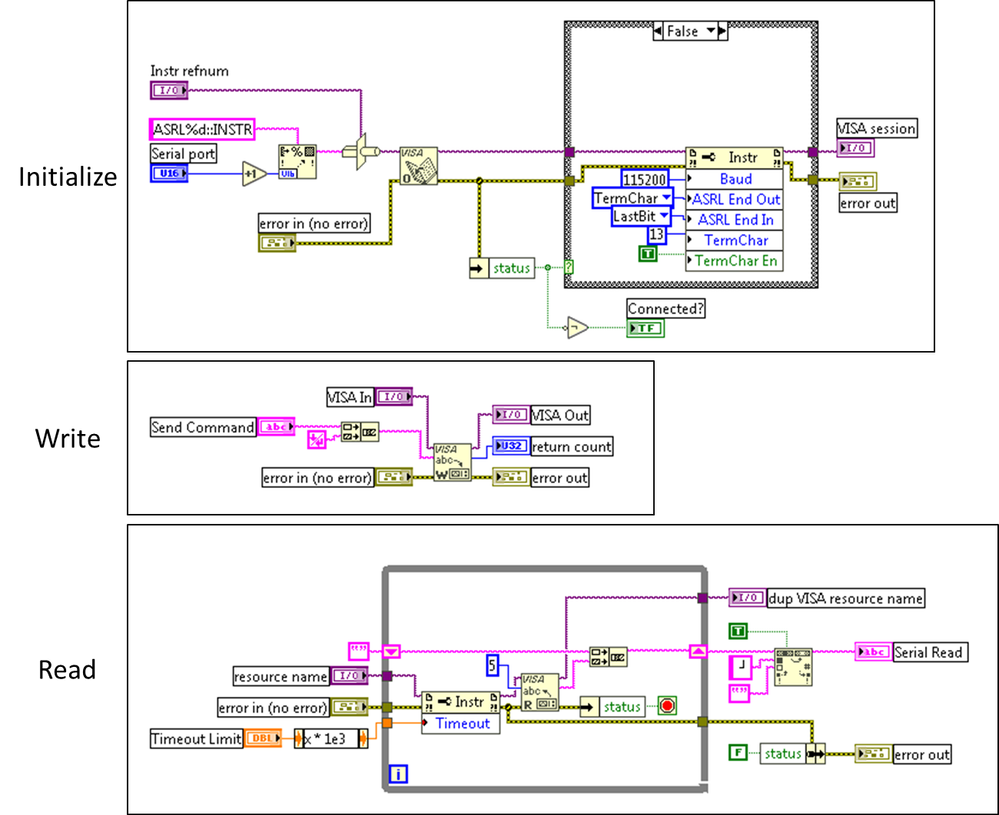

I am working with a custom control board that I communicating over RS232. It has been used in my company for some time, so I have some LabVIEW code to communicate with it. I am not very knowledgeable about serial communications, but it seems like we are not reading it in the most efficient way. We read 5 bytes at a time in a loop until we hit a timeout.
We have a command set of ~40 ASCII commands. The responses vary in length quite a bit. Many of them end with "\r>\r>" (slash codes display), but not all of them. Some of the commands put the board into a state, like waiting for a trigger, or waiting for USB data to be sent. Those responses end with "\r>\r>[MNGR/EXPOSE]\r" and "\r>\r[MNGR/RECEIVING]\r" respectively.
When the return messages are very long, it can take up to 800ms to get the entire response back, so we set the timeout to something like 1000ms, but then the read function will add an additional second because it waits to timeout. Pictures of the VIs shown below, please let me know if you need any extra information about the device.

Initialize
  • Just use the Configure Serial Port.  No need to use the property node or the VISA Open
  • No need for the Type Cast.  Just run the string straight into the VISA Resource input on the Configure Serial port and it will coerce.
Write
  • No real need for the return count unless you really need to know how many bytes you wrote.
Read
  • Pure an simple: that board has a HORRIBLE protocol.  If you have any ability to have that updated, I would.  The only real change I would make is to force them to add a Carriage Return (CR, 0xA, 10) to then end of every message.  Then you can just let your termination character handle everything.

Crossrulz,
The controller board comes from a parent company who uses this board and our devices, so I doubt my request for a change to the protocol would get anywhere, but I can try. By the way, when I look at the carriage return constant in hex view it is "0D", and linefeed is "0A". Is LabVIEW's definition different than standard?
Assuming I can't get the protocol changed, is waiting for timeouts the best (or only?) way to make sure I have the entire response?
No, that was my mistake.  I was hurrying to get out the door and stated it backwards.  I'll probably mull over this in my sleep and come up with something better.  Though, that might require knowing the entire protocol.

I would make the Termination Character 0x0A, Line Feed, as that is not only the more common "standard", but it is one you are using yourself, since you append the "End-of-Line, CR/LF" string to your Command Line, and that is 0x0D, 0x0A.  But you need to "experiment" with your device and see if that works ...
Have you tried reading 1000 bytes instead of 5, and letting a Termination Character end the string for you?  Are there instances where this doesn't work?  [I haven't read the Protocol, but crossrulz seems to indicate that this might not be a feasible idea ...].

Hi all, thank you all for the suggestions.
First a question: is it standard practice to put a small wait after a Write function like in mcduff's example? Or does it just depend on the device?
And an update: I have heard back today from the firmware programmer that the termination character is indeed ">". If I set the termination character to 0x3E, everything appears to work pretty smoothly.
For some commands, the board will acknowledge the command, go into a certain state, and acknowledge when it leaves that state. I know ahead of time which commands will require multiple reads though, so that is ok...
I think the reason I was getting "\r>\r>" earlier, is because I don't need CRLF when I write a command, just CR.
