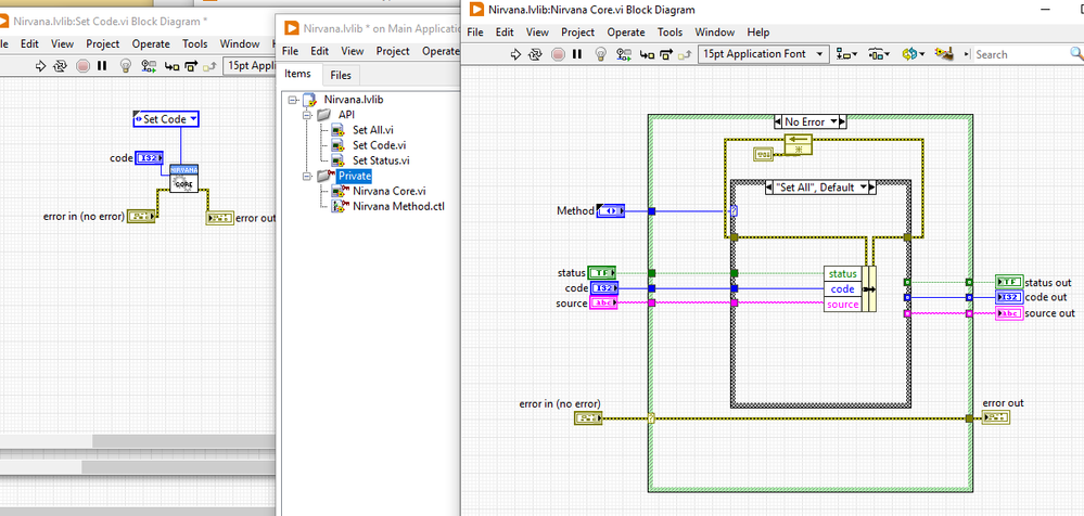

A little esoteric knowledge since both Mark and Bill are correct half the time.
Do multiple Unbundles force LabVIEW to copy the cluster data at each wire branch or can the compiler optimize and reuse the cluster data copy?
The answer may be.  If the cluster wire is brownish the data is contiguous in memory and the compiler might feel safe enough to operate on the same buffer otherwise, the cluster wire is not brownish (pinkish or greenish) and the data may be non-contiguous in memory and only copying the whole cluster data is safe.
To be honest, I disagree that branching the cluster to multiple unbundle nodes is cleaner than bending a few element output wires if you properly label your wires!
And if you still don't like that, make the cluster a class and use property nodes.  Or treat it as such in an action engine with get and set <element> actions wrapped with the "Nirvana" AE API vis.  Either of those choices force LabVIEW to share the Cluster data buffer in either the Class or on the SR/FBN of the AE Core.
"Should be" isn't "Is" -Jay

Since I did mention Nirvana...... you should get some Idea from this incomplete lvlib
