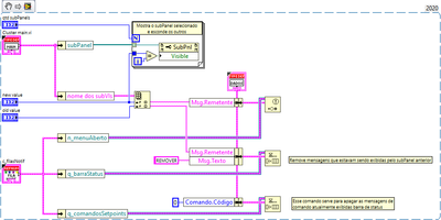

I have a doubt about the Unbundle cluster instruction.
Is there any performance issue when using "multiple unbundle" cluster when comparing with a "single unbundle"?
Consider that I'm using the data inside a subVI (without the need of showing data in the Front Panel)
See the attached example:
Example 1 uses only a single unbundle and the wires go straight to the "control" (control can be a more complex logic like a subVI)
Example 2 uses multiple unbundle and each unbundle is associated with different instructions
I'm asking this because the Block Diagram would be more readable (see example below)

I believe that unbundling separately creates data copies at each unbundle node.  This could cause big performance and/or memory issues if the cluster contains a lot of data.
So, for normal use, it doesn't really matter, but if you need the ultimate in performance, use one unbundle and expose the elements you need to unbundle.
I suspect the compiler would most likely optimize this since it is clear that the data will not get modified. It is being read and passed to a subVI. The copy for the subVI will be there regardless. More likely than not both code constructs would compile down to the same code under the hood.

I had a huge performance increase when I went to a single unbundle node for a cluster that contained a huge array.  I had unbundled different elements in different places just like the OP showed and it was slowing everything to a crawl, but when I unbundled everything in one place, it went away.  I was surprised as heck, and that was the last thing I tried because I believed the same thing you did.

When reading the help for "Show Buffer Allocations", the burb for cluster did say:
  • Clusters—Displays buffers for clusters on the block diagram. If you want to reduce the amount of memory LabVIEW requires to run the VI, avoid using hierarchical data structures, such as clusters or arrays of clusters that contain large arrays or strings because LabVIEW cannot manipulate these structures efficiently and might cause a VI to use more memory.
So maybe my experience falls under the "cannot manipulate these structures efficiently" umbrella.

It probably depends if the unbundle needs to make a copy or not. Also don't forget the unbundle of the IPE structure.
Message 9 of 16
(3,031 Views)
There's some old thread where someone had an array of clusters which included arrays of ~100k elements in each, and just indexing out some other element was really slow. I changed it to IPE and it was improved a lot.
I couldn't find it in a (very) quick search. 😕
Now, if such a structure causes issues with a single unbundle i'd expect multiple to make it worse, but hopefully the compiler has improved so it isn't such a big issue anymore.
