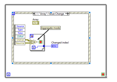

Hi GerdW,
essentially two issues:
1. how can i manage the front pannel to fit a possibile high number of element
2. how i can resize it and show runtime in the front pannel before the user use? Meaning that my array have to remain an input. I can use initialize array but i get an indicator in that way
3. assign a name to each element
4. present the input with the string alredy filled so that OP can't use it
I have found something like this, but i struggle in adapting it to my cluster case:
I'm with Labview 2019
Best Regards,
Zuc
Message 9 of 19
(983 Views)
Hi Zuc,
So there are 4 bullet points for your "two issues"? 😄
  1. There are property nodes to set the number of visible array elements and the change the frontpanel window size…
  2. Basic LabVIEW knowledge: to set values in a control you can use a local variable of that control (or a "value" property node")…
  3. You can set the string value for each cluster element in your array. What's the problem?
  4. You can set cluster items to "disable", either using its property dialog or by using a property node. Again basic LabVIEW knowledge!
To give you another idea to think about:
Depending on the requirements I prefer to use a MultiColumnListbox (MCLB) to show a variable number of items to the user.
The user can select a row in this MCLB and you can show settings for that item in separate controls/indicators. When the user operates those separate controls you just update their values in your data storage and in the MCLB display…
Message 10 of 19
