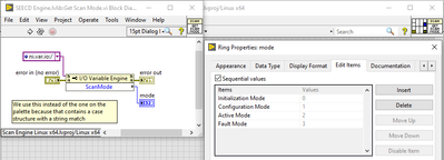

What do you mean exactly with late count on the status ? As  I said, sometimes the indicator Async Loop Late of the Scan Engine and EtherCAT VCD is incremented.. I also have some HP Count ( i.e. VeriStand PCL is late...).
The indicator Scan Mode State goes in state 3 when the error occurs.

I spent some browsing through the source code of GitHub - ni/niveristand-scan-engine-ethercat-custom-device: Provides NI Scan Engine, EtherCAT and Re...
The value 3 of the Scan Mode State indicates that it is at the fault state.
Enable reconfigure ECAT will restart the scan engine, just like how you can restart it in DSM.
