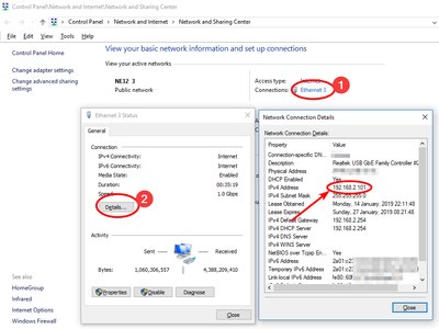

I can't make this work. I can only access it locally on my own computer where the web service is published. I get my IP by whatsmyip.com and enter it in the client/ web browser (IE) on the other computer, but no luck. I have also tried to switch off firewall on both computers, but still doesn't work.

I would think that going outside your network to get your IP address will return the IP of your gateway?  Why not do an ipconfig instead?

  1. Same network: You got the wrong IP. You need the IP your serving computer uses in the local network. On Windows, you can find it either through the control panel, or via the command prompt, typing ipconfig.
  2.
    Through the internet: This is gonna be tricky. The IP you got from whatsmyip.com is most likely the public IP of your internet router, not the IP of your computer. That's because of the feature NAT mentioned before. In easy words, this public IP is your house number. The private IP is the room number. Only the receptionist at your house's door knows both. External persons know only the house number, internals know only your room number. If someone from outside wants to reach you, the receptionist has to forward him/her to to you. In other words: This needs configuring in your router. Better ask a local expert, as depending on your network's configuration you can break a lot.
