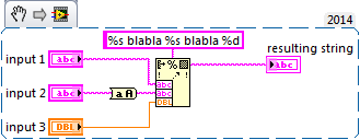

Like this?

hi RamonG,
unfortunately this will not work for an enum input 😞
EDIT: i know that i can change before and after, but i wanted the 'format into string' function to do that
