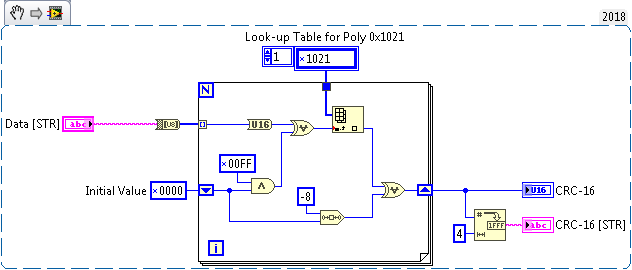

Here is a modified version of my earlier code that works for your examples.
CRC-16 (CCloggie).pngThe initial value should be 0x0000, the polynomial should be 0x1021 and the value is the CRC-16 value, not the augmented value. The table in your previous documentation does not match the polynomial in the document. However, the above code works correctly for the examples you posted.

I did some experimentation on how efficient the two methods were and if your data size is about 60 bytes or less, jamiva's method is more efficient. Once the data size gets larger, the lookup table method I posted is much more efficient. Here are some averages I calculated.
Data size = 10, LUT avg = 0.0000207s, Calculation method avg = 0.0000111s
Data size = 100, LUT avg = 0.0000251s, Calculation method avg = 0.0000361s
Data size = 1000, LUT avg = 0.0000581s, Calculation method avg = 0.0003332s
Data size = 10000, LUT avg = 0.0002564s, Calculation method avg = 0.0028020s
Data size = 100000, LUT avg = 0.0012553s, Calculation method avg = 0.0153443s

Here is Mark Yedinak's code (I don't want to take credit for his work. Give him the Kudos). I just stripped it down to the bare minimum for your particular application. Mark's snippet didn't contain the subVI to generate the Lookup Table, so I just inserted an array constant instead.
BTW, the VI in my previous post doesn't give the correct CRC with your data. I didn't bother debugging it since Mark's code works well.
And I just cleaned it up a little bit more (removed the AND 0xFF and replaced with a To Unsigned Byte, which also removed the need for the To Unsigned Word).
