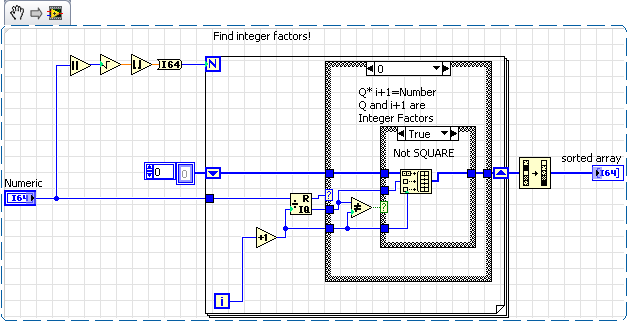

Thanks everyone. If you guys don't mind, can we stick to the while and case structure scope for now. The VI is
still not working.
It seems the false case, is also outputing its value.

You switched the constant going to quotient and remainder to 0 instead of 20.

Take a closer look at your Quotient and Remainder function.

Of course, this works fasterSmiley Happy
( finding all factors of an integer)

1 less iteration required since we know 1 and Numeric are factors we can skip that iteration and test 2 through
Floor (SQRT(ABS(Numeric)))

Thanks for the interesting challange- I went a step further to add this in my reuse code and added tests for perfection, primacy and squareness.  The special case handling (Number = 0 or 1) made it fun to test!
