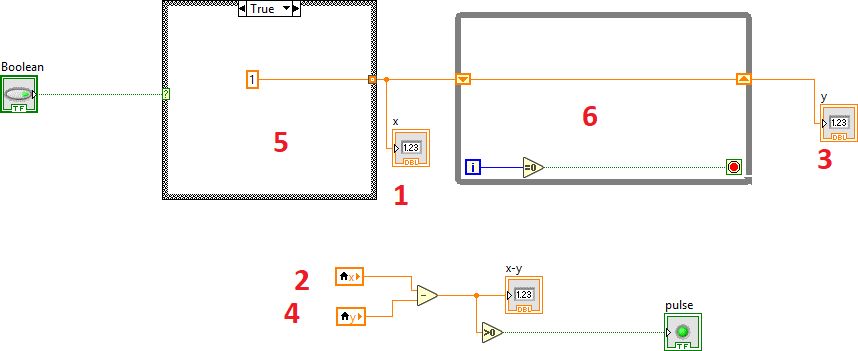

Voici une copie de l'écran pour ton idée.
Il faut allumé le "Highlight execution" pour que tu puisses voire la pulse.

(I made a friendly reply. I cannot guarantee that google translate keeps the same tone)
Your code does not solve any problem whatsoever and makes no sense!
Sometimes, the truth hurts! Let's have a look:
  • You are reading from a local (2) and writing to its terminal (1) in parallel. Most likely, (2) occurs first so the value is not predictable because it may depend on an earlier run.
  • Same for (3) and (4).
  • Your case structure does the same function as boolean to 0,1. No need for any structures
  • You are dealing with integers, no need for any orange.
  • You while loop only iterates once. Nothing would change if you would just delete it.
  • You don't have a toplevel loop. Is this a subVI? How are you calling it? Continuous run?
  • x and y are always equal after the code completes. So what's the point?
As I said, your code is highly flawed and does not solve any problem and is not guaranteed to generate any "pulse", whatever that means.

Bonjour monsieur,
Si tu veux générer un signal il faut que tu passes par un 'daq' ou un 'mxdaq'.
Par contre si tu veux générer une pulse (fonction dirac) tu peux utiliser cet algorithme.
Les 'local variable' sont mis pas juste pour ce code, si tu as un grand code et tu veux mettre l'algorithme à part et la pulse à part, tu passes par ces variables.
Avant que je postule la figure, le code a été testé.
Si tu veux l'utiliser tu peux, sinon laisse tomber.
Bon weekend

No, the code is highly flawed and is not guaranteed to work because its outputs depend entirely on unpredictable race conditions. Did you even read my comments? How exactly did you test it? What was the test result?
