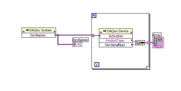

 You can programatically determine the USB device serial numbers & Dev #, you would then use that information to setup your tasks correctly no matter what Dev# is assigned to the devices.

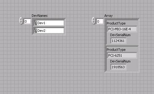

 Here's how you might do that:
Here's a screenshot of the front panel:
