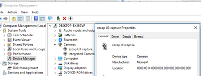

It has device manager properties information as follows

@constructionworker wrote:
By the way, getting video from the serial number camera does not solve the problem. Because after the application is created, a new converter installed instead of a burnt-out converter will have a different serial number, so the program will not recognize this serial number.Does anyone know how to find out which compport is actually assigned to the physical port
There is no COM port! Just an USB one. And USB has no concept of distinguishable ports on a computer. The distinguishing happens through what device you connected, what make and model and if that is not enough, what serial number that device has. If it has no serial number, or you can switch serial numbers, for instance by replacing a defective device, your application needs a means to let the user select that this new device whose serial number it hasn't seen before, has this specific function and should be assigned to this application specific alias. Anything else is never gonna work.

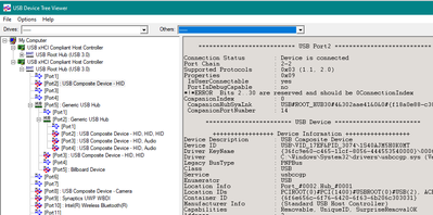

At the risk of derailing this post, there are methods of obtaining what is connected to the physical USB ports... and I have done it in LV a long time ago, before realizing there are better ways. Trust me, you do not want to go down that path.
I'm actually curious about this method. So how can I find the interface name so that it can be used in NI-Vision based on the physical port number?
Does anyone know of a way to programmatically change the name of the assigned camera interface?
Yes, use the System Configuration API.
