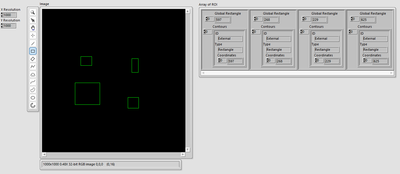

I have a basler camera that can "focus" on four region of interest before I acquire the image and as a result it gives me a single one image with all the four ROI. In the basler software I can decide the coordinates of the four ROI and it gives me a single image. How can I do that on labview? How can I choose before acquiring the image the coordinates?

If you want to manually select 4 ROIs you will need an indicator and an image with the same resolution, a previous capture would do nicely.
Use the ROI tools to select your ROIs, use the CTRL + click and drag to add a new ROI. The ROIs are stored as a property of the indicator. Use IMAQ Ungroup ROIs to separate them.
