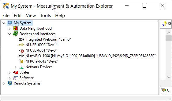

I'm a little confused.  When I open MAX, it tells me what devices are plugged into my computer (camera, DAQmx device, printer, communication device, etc.).  Can you post a screen-shot of your PC, running MAX, and showing Devices and Interfaces?  I'm assuming (??) that your Com Ports will show up as "something".  Here's an example:
If you can "see" your Com Ports, you should (I hope) be able to "interrogate" them to discover what is attached, and if a Camera, what is its Serial Number.  Once you do that, you know (from the Serial Number) which Com Port has Camera 1 and which Com Port has Camera 2, and don't care into which USB connection on your PC is being used.
Yes, I can see the serial numbers, both are different.
Well, let's say we found the comport assignment according to the serial number of the 2 converters I have now, but what will happen if converters with different serial numbers are used in the application after creating and distributing the application?

Where are the COM ports in that image, you have been talking all the time about?
VISA is not coming into the picture at all here. But the principle of using IMAQdx functions to enumerate the camera and read any serial number would be similar.

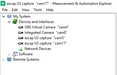

You will need some 1 time setup.  Let's use your screenshot.  And assign Alliases as:
  • Workbench
  • Laptop
  • Lobby
  • DogPark (so you can see who doesn't pick up poop)
Plug n pray will remember the UID of each device and reuse the Aliases whenever the same device is plugged into your exact machine even if the exact USB path swaps. But, if you need to replace the camera "DogPark" with a new one, (because, it was damaged by someone angry over the ticket, of course!) You need to reconfigure.  It's simple to use the System Configuration API to list all detected devices by serial number and Aliases and you could even assign a new Alias to any present device that has a default "camN" Alias.  Look in my tag cloud for a relevant tag.  I'm sure there is a rename Alias.vi example in there somewhere.
"Should be" isn't "Is" -Jay
