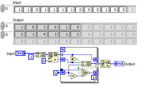

I am trying to create a VI that takes a 1D array input and generates a 2D array output. The array input is an array with just 0's and 1's. What I want the output to be is an array that has 0's and 1's on its first row and on the second row a count of the consecutive number of either 0 or 1 on the input array. This might sound confusing, so I'll give an example.
input
[1  1  0  1  1  1  1  0  0  0  1  0  0]
output
row1 [ 1  0  1  0  1  0]
row2 [ 2  1  4  3  1  2]
So basically the first row is just 0's and 1's in alternatig order (it starts with whatever is on the zeroth position on the input array) and the second row gives the number of consecutive 1's i have before the next 0, or the number of consecutive 0's before the next 1 on the input array.
 I thought about using a case structure but I am not so sure how to set it up, so any tips would be helpful.
A case structure selects from alternative code and has really nothing to do with your problem. All you probably need is a  FOR loop, shift register, conditional tunnel, and some trimmings.
Sorry posting by phone, cannot make example. Still, should only take a minute.

There are many simple ways to do this, here's one possibility:
(once you tell us your LabVIEW version, I'll attach the code)

Accepted by topic author sebas98
@sebas98 wrote:
The input array would be of type double, as well as the output array. The output array should be in just two rows.
OK, did not see your response. You can definitely make my code into a subVI.
(Note that you might need to tweak a few things if other numbers can occur in the input. In principle it will work with any number of different values, not just 0,1)
It is wasteful and potentially dangerous to represents 0, 1 in DBL. Why can't you use integers? You should!

@sebas98 wrote:
I was using doubles just because whenever there is a number I automatically select it. I don't really have a criteria to chose the type, so I just go with double always. But if you recommend using integers I'll go with it.
Doubles will give you problems. Use doubles if your data can have floating data. If not, don't.
Especially comparison of doubles is not recommended (in any programming language, AFAIK). A double displaying 1 and another one displaying 1 might not be equal. Be warned...
Besides that doubles are less efficient in both CPU use and memory.
