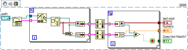

P@Anand wrote:
No sorting the time array doesn't seem to work good. You can try Timestamp sorting method and DBL sorting method with a folder containing large files and check the difference. The DBL sorting method gave me exact sort which I did using my windows explorer sort by date modified. (Please correct me if I am worng)
Here's a snippet that compares the results of sorting modification dates as timestamps versus as DBLs.  In the folders I checked, both produce identical results.  If you can find a mismatch, could you post a snippet or VI containing constants for those timestamps?  I think that would be a bug in LabVIEW.
Message 18 of 25
(4,598 Views)
Its my mistake the bug is with my logic in the timestamp sorting. I have swapped the inputs for the search array in the 2nd for loop.
