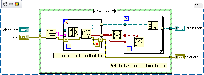

You have the File/Directory info which gives you the time stamp where a modification is done or newly created. You can use the list folder function and check the file info of each file and sort the files to the latest. Attached is an example for getting the latest files in order.
Good luck

There is a mistake in the code that I have attached. If you are planning to use it please use this.

Hello, thanks a lot for the code. Can you help me with this now? I have two codes the one that you gave me and the other that i have develop. Your find the latest update and mine preview an image from a foder. How can i connect this two in order when i run the program to sort the image and then preview the image
Message 7 of 12
(5,128 Views)
You have to take the last path in the array of path to get the preview of the latest file.

Check out the function Delete from array, especially the output "Deleted part", it'll give you the last element of an array.
