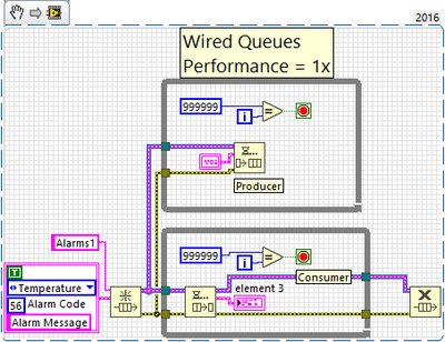

I made a simple error in my last post.  I left a Destroy Queue in place.  After removing it there was much better performance.  After testing all of the suggestions here are my findings.
Wired Queues have the best performance and all other methods will be measured against using only wires to pass a single reference.
Performance = 1x
Named Queue with (Obtain/ Enqueue/ Destroy) combo where needed
Peformance = 10x
Named Queue with Non-Rentrant FGV Sub-VI
Performance = 4.5x
Named Queue with Pre-Allocated FGV Sub-VI
Performance = 2.2x
Hybrid Named Queue with Pre-Allocated FGV Sub-VI Wired inside each loop.  Basically this method cleans up all the wires between various loops and has very little performance overhead.
Performance = 1.06x
All things considered, I will end up using the Hybrid method.  It allows for a clean block diagram and has very close performance to using native wires.
Thanks for all the suggestions.

How are you determining "performance"? Your first and last setup are pretty much identical, so if you are seeing a 20% "performance" difference I don't think your measure is accurate.

@gregoryj  ... I made a wrong calculation. My actual performance difference is 1.06x.  I have updated my post to reflect this.  The measurements were made with very simple vis in order to get a relative idea of performance.  In this case I only ran the VI for 1.17 seconds.  If this were in a real application running for a long time the performance difference would approach zero.
