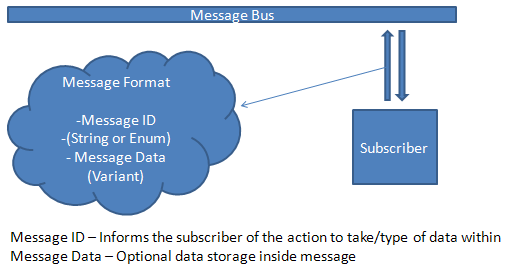

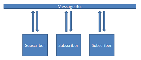

Let me introduce the idea of a Message Bus. You have subscribers to a message bus that can send or receive messages and perform actions as a result.
A subscriber spends most of its time waiting for a message on the bus, and once its received a message, it can choose to discard or process it, and perform any neccessary actions.
So what is a message? Its a user event that contains a Message ID and Message Data (as shown below)

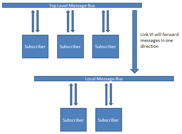

Ok, thats good so far, but what about SubVIs?

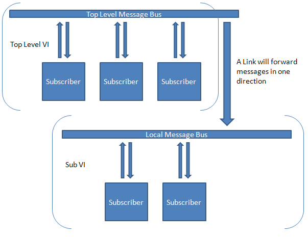

I propose that SubVIs (By this, I mean major SubVIs, that contain a big portion of your programs functionality like the DAQ handler, or a Comms handler) have their own local message bus and are linked to the top level bus via a Link. This means that all Top Level messages like Stop commands/Control commands are forwarded to the local message bus. This allows you to Stop all the subscribers (and hence the SubVI) from the top level easily, as well as send configuration/start/data messages. Now you have something that conceptually looks like this:

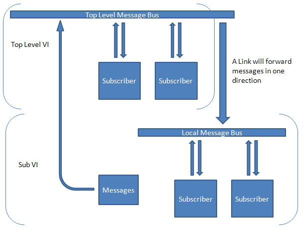

Now I'm thinking- how I report things like error data back to the top level so it can decide whats next in terms of program execution?
...with this architecture its easy to send data back up to the Top Level VI too.
