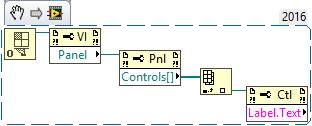

You can use VI Server to get references to all the controls and indicators from another VI, then filter by the Control/Indicator label. From there you can just use the property nodes to make the necessary modifications.
Thanks for taking the time of making this example, this is exactly the kind of solution I was looking for. I tried it out and it works great. The downside is having to find the correct control among the "control reference"-array but its solvable.
I made a small example project consisting of two build specifications having the same main.vi but one of the builds gives an application that does not have a button (mode) and a superuser application that has access to the button and can switch a value that is shown.
