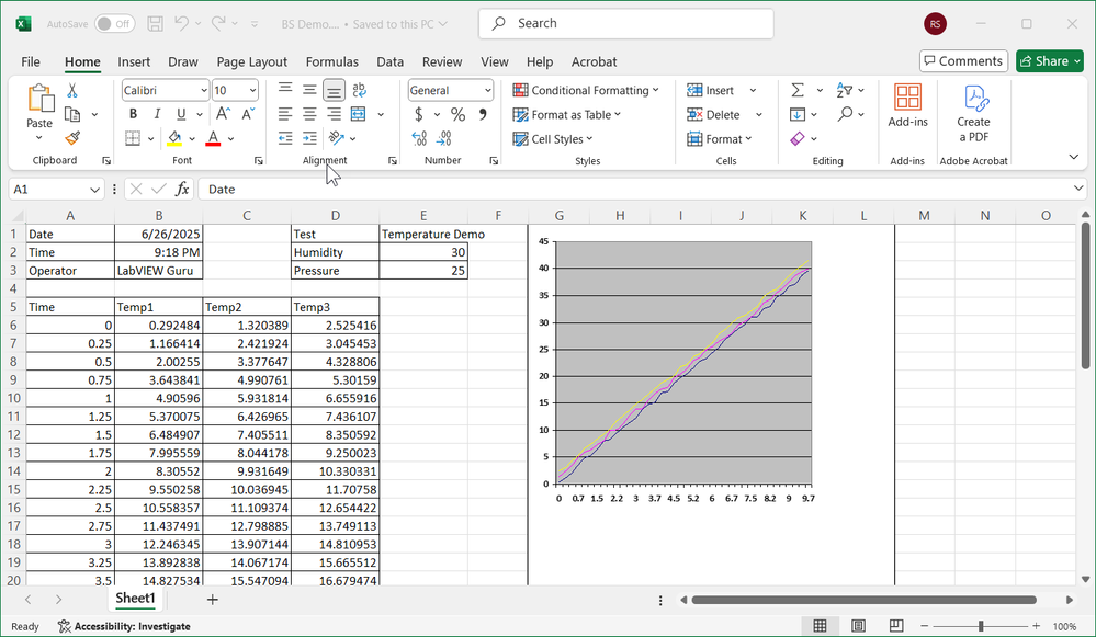

A decade agp. I posted a "Revised Generate Excel Report Example" here on the Forum that included putting a Graph in the Worksheet.  Here's (a part) of what it just generated when I ran it:
Excel Demo.pngGranted, it's a minimal plot, but it's a demo, for goodness sake.
Why don't you post your VI (preferably in a version of LabVIEW 2021 or older (as I can't open LabVIEW 2025 (yet)), and enough "supporting VIs and data" that we could "try for ourselves" to make it work?  [Of course, if you are using LabVIEW 2025, and the RGT really is broken, all I can say is that it's been working fine for at least the last 12-or-so years ...

I fixed it removing the graph generation trough code and defined it (the graph) into the report template, I set it to be fed by a range of cells where I put some dummy data and then, at runtime, I filled such range with the real measured values;
this removed the chanche of bug and IMHO it is a much cleaner solution since the graph is visibile also into the template and can be modified in layout without the need of editing the code.
