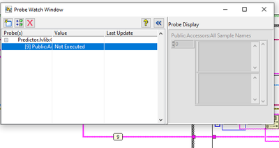

Index 2, 0, 1 cua em connect to wrong one. Em phai noi cai voi cai dau vao thu 2 (second input) de index column. Khong biet dien ta vay em co hieu ko.
Khi em debug code em co biet dung highlight va probe ko? de xem value cua no. Em phai biet debug thi moi develop code duoc.
Highlight de lam cho code chay cham lai minh co the xem chuong trinh chay the nao va gia tri cua tat ca cac wires.
Probe de minh xem gia tri passed qua mot wired trong chuong trinh.
Anh thac mac la em co the lam OCR/OCV ma ko nam ro may cai index array nay.
