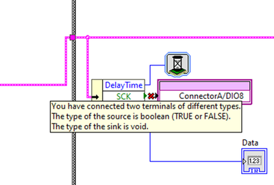

HI, Ty for the code.
Im new to labview and im having a little bit of touble getting the code to run, im having this issuue, Could you help me?
