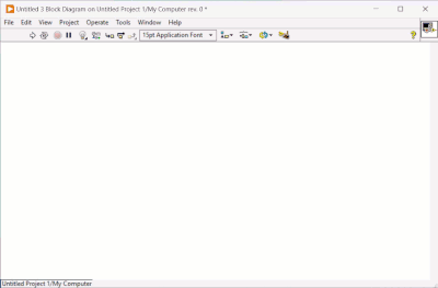

@PNR wrote:
The (blinking) cursor position for text boxes (strings, labels, etc.) is off by a few pixels when zoomed.
The thinner bar on the left is where the next character will actually appear. The wider bar to the right is where the cursor is blinking. It works just fine, just looks a bit strange when working with text while zoomed.
This looked fine up to max zoom in Linux Mint.  There was no extra spacing between the cursor and the blinking line (in Linux), as shown above.
Message 36 of 48
(3,952 Views)
@PNR wrote:
Text can also wrap differently depending on the current zoom level (Size To Text is disabled).
So far, I'm impressed with the Linux version.  I could not reproduce what you demonstrated in Linux Mint.  The wrap remains as it should when zooming in or out.  I tried both having the entire text on a single line, but resizing the string constant and when there is a carriage return between Hello & World!.
I never thought I'd become a fan of this feature, but as vision is not as great as it used to be, this is actually a nice feature that I have already adopted.  Thanks NI!
Message 37 of 48
(3,951 Views)
@PNR wrote:
Here is one more. When dragging the icon of a VI onto a zoomed block diagram, artifacts will remain in the dragged locations. It appears that the wrong region on the screen is updated as is visible in one of the zoom levels in the example below. The artifacts can easily be fixed by resetting the zoom level or scrolling. It also does not seem to affect any other drag operation.
I reproduced this in Linux Mint.
I also noticed an interesting behavior and will pay more attention to it and will report it in a separate thread.  It seems that when adding a new VI to the project and opening that VI, the opened block diagram is minimized.  I was not able to reproduce it and I do not recall if I did something unusual....
As I tried to repeat the steps that cause what I wrote above, I noticed that when placing the icon of another VI on the block diagram that an artifact started but then it stopped and it displayed correctly.
Message 38 of 48
