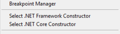

1. In addition to "constructors" sometimes I just want a reference to a .NET class.  For the older .NET version, you could right click a reference constant, say "Select .NET class" and then "Browse" for the class you want.  It seems there's no way to browse for classes in .NET Core assemblies.   The constructor gives you the option to explicity select which type of .NET constructor you want... the constant options do not.  Even if you start from a .NET Core reference, the browse ONLY seems to let you work with .NET Framework objects.
2. I am occasionally running into an issue where when you try to create a constructor, the "options" for constructors is just blank... It doesn't show the "This class contains no public constructors" text, and does show anything actually available to work with, nor does it show the "error" message.
