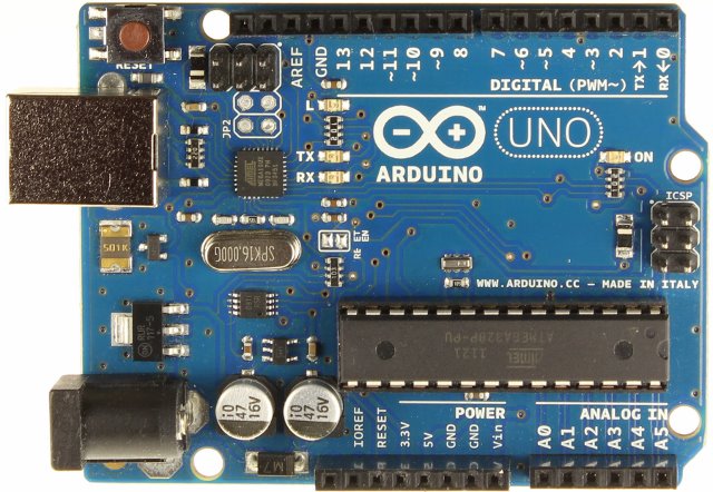

This is the arduino i have

The Analog Write (PWM) function works with digital pins.  See:
<http://arduino.cc/en/Reference/analogWrite#.UxJayuNdU_o>
The example uses pins 4, 5, 6, an d 7.  Look at the right side of the front panel.
I don't know how the author of the example is using the analog pins.
