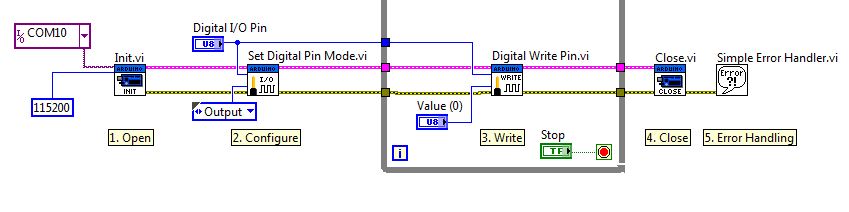

Hello everyone,
There are some discussions about this problem, I have tried them but still error 5002
I'm doing this example https://decibel.ni.com/content/docs/DOC-20044#/ .I try labview+arduino together and then I am going to make my own things.
What I have done:
- Changed Arduino COM11's baud rate to 115200 in Device manager
- Created manually Baud rate (115200) and VISA Resourse (COM11) -constants --> did not help
- I have Labview 2012 (64bit), NI-VISA 5.4

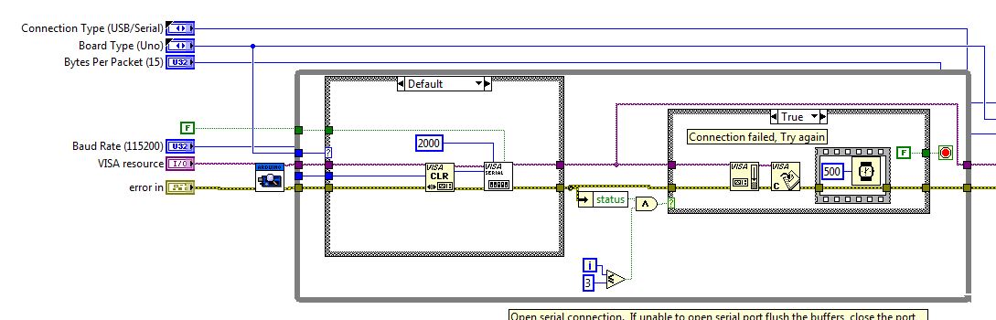

Init.vi Block Diagram. Do I have to add something here?
Have I forget to install something..? I'm little bit frustrated with this
Big thanks for any help!

  1. Many LabVIEW toolkits do not work with 64-bit verisons of LabVIEW.  The 32-bit version is probably the most commonly used version.
  2. LIFA is quite old and it deprecated.  It has been replaced by LINX, you should use LINX instead.
