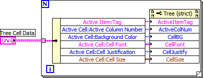

The only solution is to add all your items and then loop through each item and set the required cell attributes individually:
 Even with setting 'defer updates' on while doing this, the process is painstakingly slow for large datasets.
