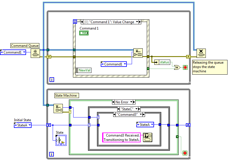

I propose LabVIEW ship with something similar to what I attached. Although it's lacking many of the features that a full-blown state machine ought to have, it does capture the basic premise: "A state describes a behavioral node of the system in which it is waiting for a trigger to execute a transition." [http://en.wikipedia.org/wiki/Finite-state_machine]
Those of you with knowledge on this subject, please comment here with suggestions for this code that might bridge the gap in making this a useful template for people who understand state machine design but also still keep it as a good starting point and learning tool for beginners.
The attached code is multiple files, since I used type defs for States and Commands. Replacing these with string constants would quickly turn the template into a single VI.
